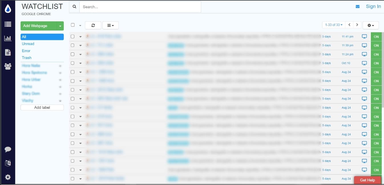

Can you click the Distill icon in browser toolbar and then click “Go to Watchlist”. This will open the extension’s Watchlist. Can you share a its screenshot? Please blur sensitive parts to make sure that sensitive information is not shared here.
Thanks!
There is a “Sign In” link in top right corner. It shows that you haven’t been able to sign in yet. Do you recall customizing the extension’s permissions in any way?

On old PC I see 33 monitors (not signed in), on new PC zero (signed in). But the main problem for me is how to move history of changes monitored page , stored somewhere locally on old PC, to my new PC. See the picture.

When I sign in on old PC a blank watchlist I can see with “No monitors found.” and without sync button. After signing out on old PC and after new opening watchlist I can see local stored monitors (see screenshot above).
