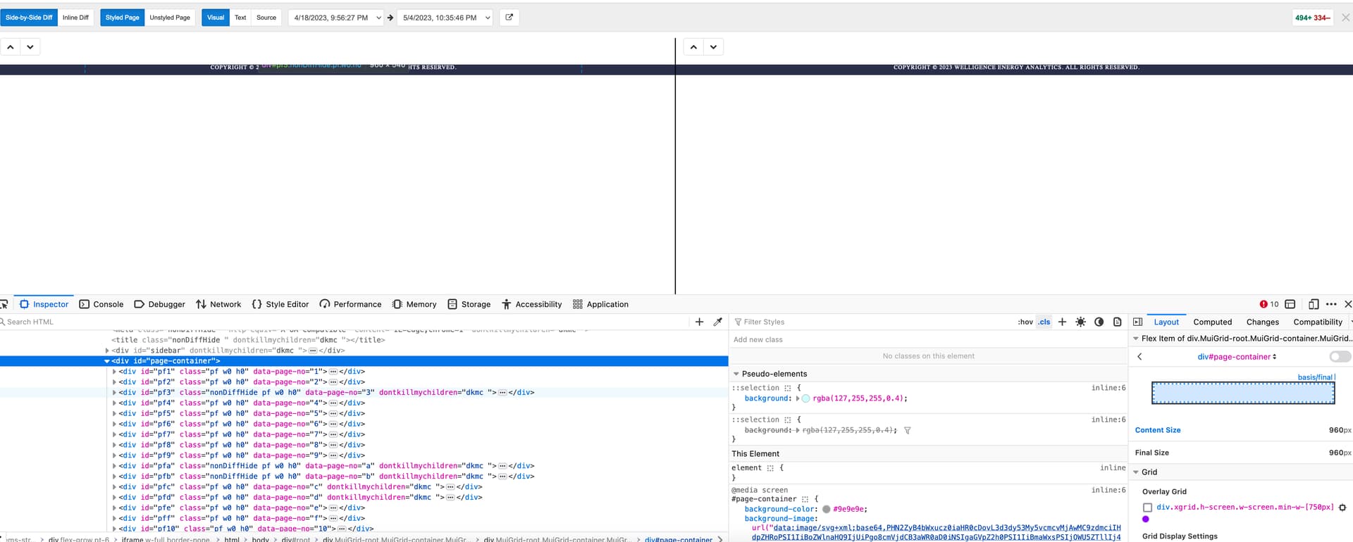

Here is an image of the element inspector to view an invisible element. Notice how the style of the invisible element is display: none. display: block is a normal style that doesn’t hide an element.
Is this image from the webpage displaying the PDF’s HTML version? Can you try inspecting the element in the “explore diff” view instead? This can tell us why the element not when looking at the changes.
Tip: Firefox’s element should show the invisible elements in gray color.
BTW, do you have access to the PDF’s url that could be monitored directly for changes? Although Distill’s PDF monitor does not render the images by default which could be an issue.
This is great, thank you for the tips. I can see that the “styled Page” for the element I’m viewing has nothing on the element.style, its just blank (see image below).
While if I toggle on the “Unstyled Page” it does have a display:block; on it;

I’ve kept playing with it and I found something that made it work! (partially):
  1. If I change the “height” in the element I can finally see the entire section, how would I make it so that this element is always showing the entire height of the document?? I’ve tried multiple options (auto, fit-content, etc) but I have to define a value on there to show everything. Anyway to make it adjust automatically for the entire set of pages?
  2. Also, noticed that the text format is completely not what it is supposed to be, it’s not matching what the document has. I do notice it’s tracking the changes, but hard to tell with the weird text sizes.
Any ideas??
Thanks again!
Andres
Thats a good find. It was an entirely different style that was causing it!
Distill computes the height of the content and sets that as the height of the iframe. In this case, it computed the height to be a very small height. This can happen if some of the stylesheets from the webpage did not load. This could also explain why the text sizes are messed up. Let me look into it next week and get back to you. Thanks!
