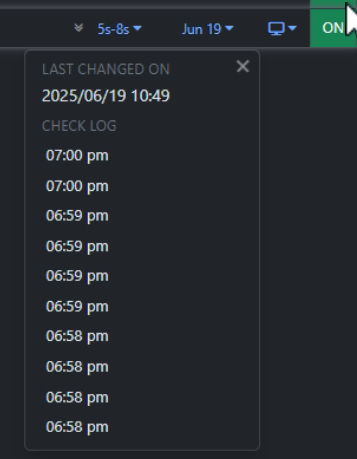

I’ve set a random check interval between 5 to 8 seconds. Additionally, I have a 2-second delay after page load before it starts scanning for changes. However, when I check the “Check Log” panel, I consistently see only 4 checks per minute, even though the settings suggest I should be getting 7 to 12 checks per minute on average.
Here’s a snapshot of the check log for reference:
You can see that even with my random low-second interval, the timestamps only show activity to the minute, and it often logs duplicate timestamps like multiple “06:59 pm” entries.
This leads to a few questions:
1. Does Distill not record every check attempt, especially when they’re close together?
2. Is the timestamp logging limited to minute-level granularity?
3. Is there a way to access more precise timestamp data (down to the second) for better validation?
4. Could the 2-second wait after page load be interfering with higher-frequency polling?
I’m trying to verify that my setup is working as intended, especially for time-sensitive drops where seconds matter. Any clarification from others who’ve dialed in aggressive polling intervals
  1. yes
  2. logging precision is in ms, display truncates it to minute.
    1. no
    1. no.
note that next check will start after the last one ends. lets say that the page takes M seconds to load and the check interval is N seconds, the effective check interval will be M + N seconds.
