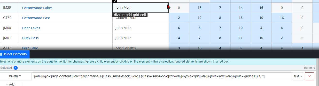

I could only select the following (John Muir):
(//div[@id='page-content']//div//div[contains(@class,'sarsa-stack')]/div[@class='sarsa-box']//div//div[@role='grid']/div[@role='row']/div[@role='gridcell'])[133]

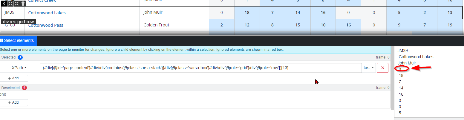

Then I expanded once like so (entire row selected):
(//div[@id='page-content']//div//div[contains(@class,'sarsa-stack')]/div[@class='sarsa-box']//div//div[@role='grid']/div[@role='row'])[13]

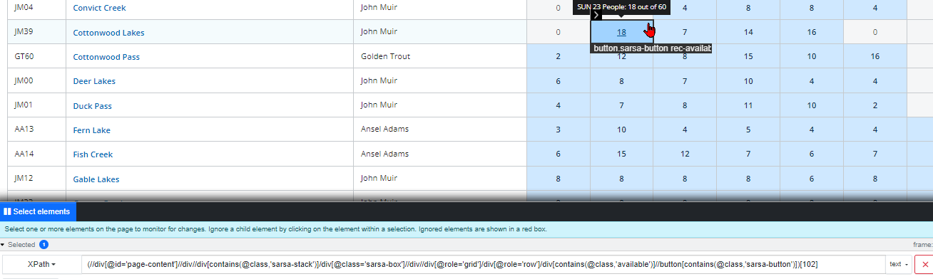

This is the button next to it, which IS selectable, but this is not the date I need:
(//div[@id='page-content']//div//div[contains(@class,'sarsa-stack')]/div[@class='sarsa-box']//div//div[@role='grid']/div[@role='row']/div[contains(@class,'available')]//button[contains(@class,'sarsa-button')])[102]

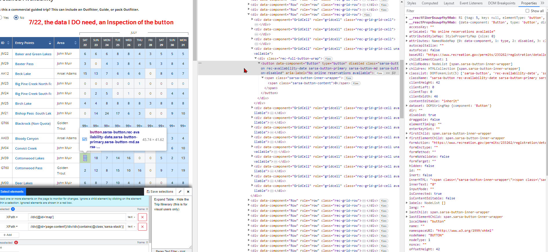

For the data I need, my cursor shows that I am unable to select the element I need, the grey box with the zero:

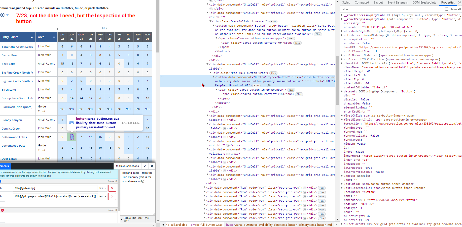

Hopefully not an overload of information/images, but did an inspect on the boxes in Chrome for you:
Thanks for the detailed information.
I changed the number 102 in the XPath to 101 to update the XPath to the following:
(//div[@id='page-content']//div//div[contains(@class,'sarsa-stack')]/div[@class='sarsa-box']//div//div[@role='grid']/div[@role='row']/div[contains(@class,'available')]//button[contains(@class,'sarsa-button')])[101]
This selects the disabled button and monitor’s its count of available slots for changes. Can you try using this and see if this works for your use case?
