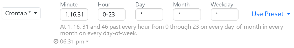

Hello, I would like to ask whether the minimum check interval using crontab can be in seconds?
Or the minimum check interval using crontab is 1 minute?
Thanks ![]()
Thanks ![]()
minute is the smallest interval in a crontab @chenyen.
note that if you need checks for all monitors to happen within a certain window, you can use “time slots for checks” option available under the extension’s device settings.
