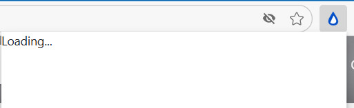

Stop working on Edge since Sep
click the extension icon but fail to load the popup page only shows Loading…

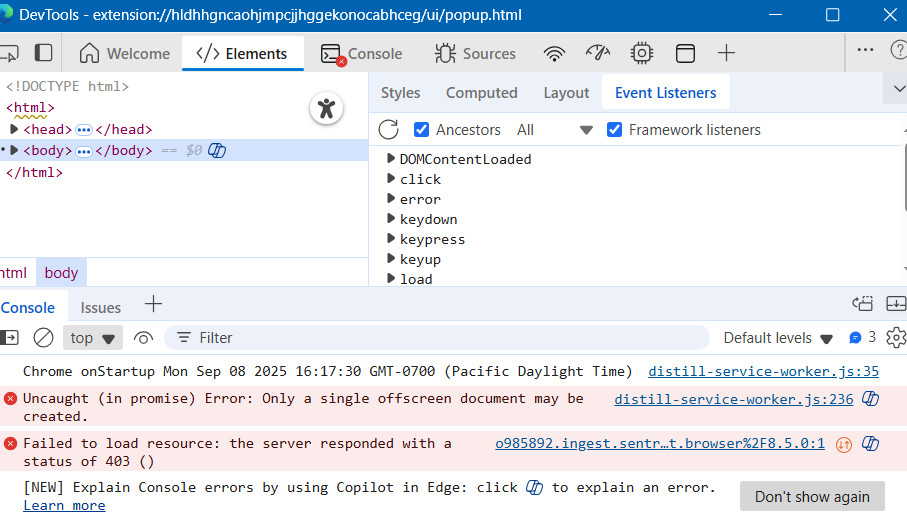

Failed to load resource: the server responded with a status of 403 ()
@distuser 403 error usually indicates an unauthorized request. can you share a screenshot of the error message?

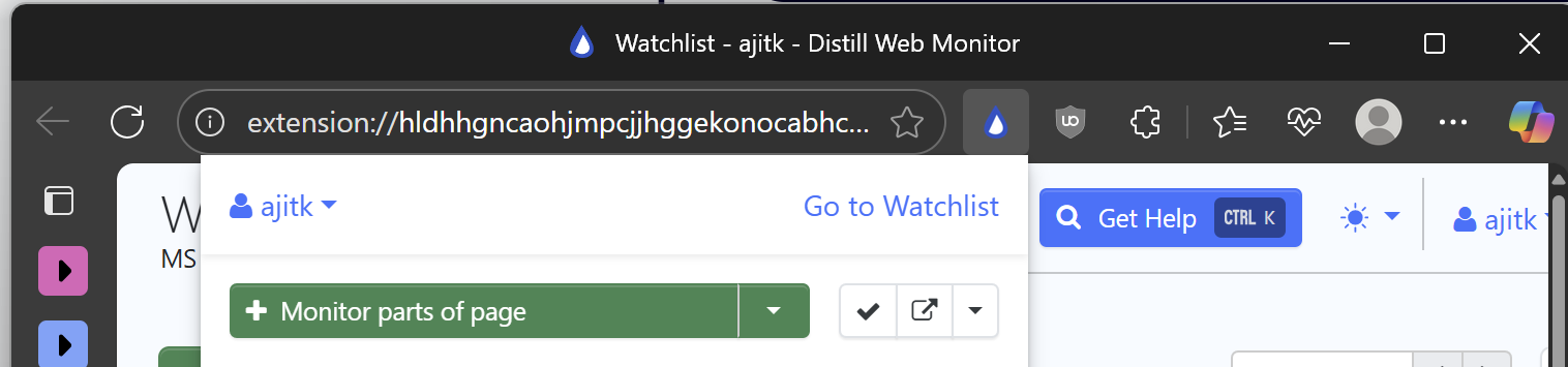

it seems to be working fine here that could point to a machine specific issue:

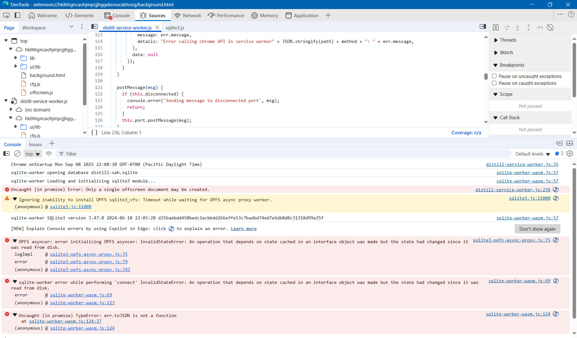

thanks for the screenshots. the error in console is related to sentry which is used for error reporting. it is benign and can be ignored. an error could have been encountered when initializing service in the background.

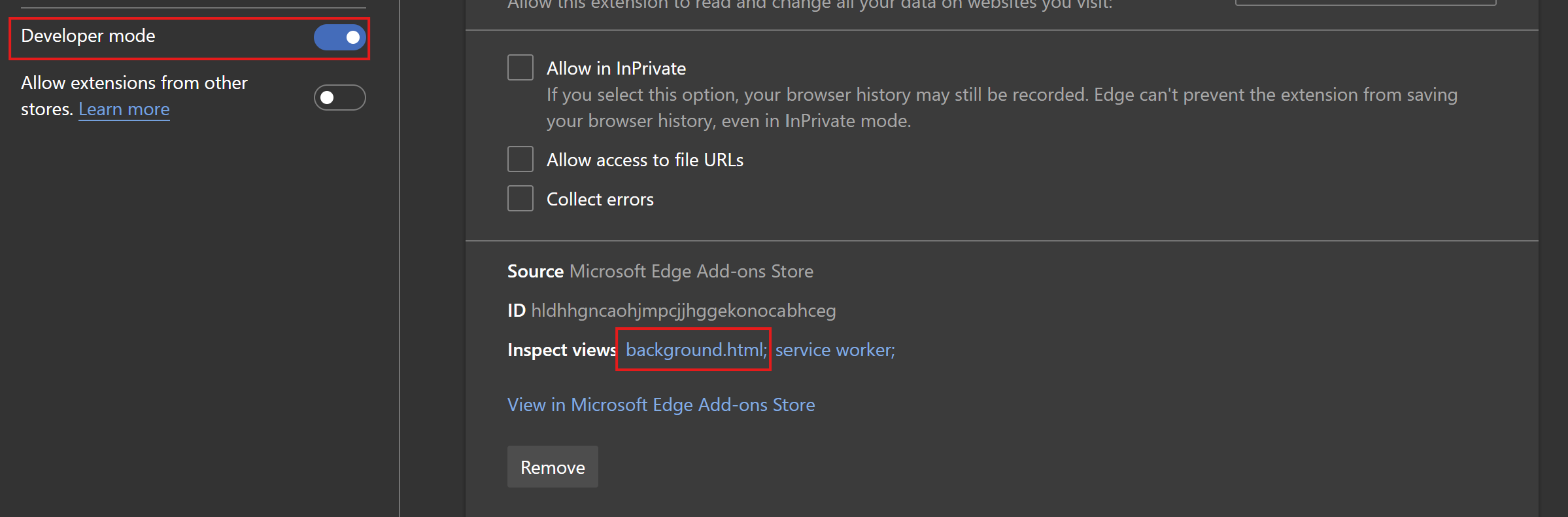

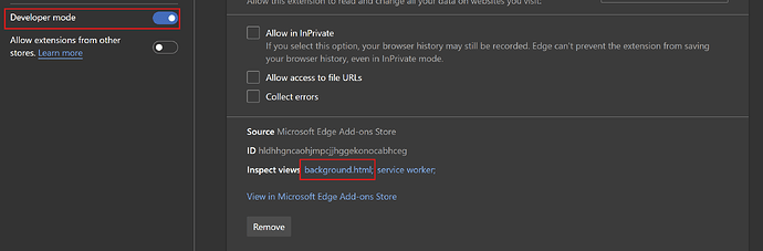

can you perform the following steps and let me know what you see?
  1. go to edge://extensions/?id=hldhhgncaohjmpcjjhggekonocabhceg
  2. enable developer mode if it is not enabled
  3. click background.html as shown in the following screenshot.
please let me know what you see there. thanks!

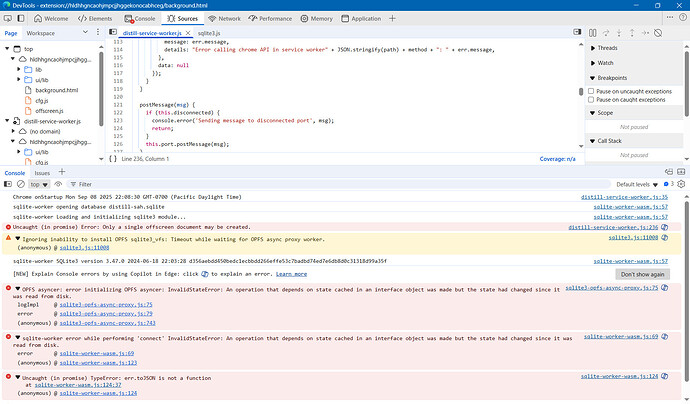

the error here shows that the extension is not able to initialize the sqlite database. sqlite uses opfs in the browser. since chrome on the same pc works and edge on my pc works, i suspect that this problem is specific to this edge profile.
can you create a new edge profile on the same pc and install the extension there? let me know what you observe.
I’ve tried private mode, clear data and cookies, still not working.
but after updating edge to Version 140.0.3485.54 , problem solved
it probably is the bug of Edge 139.0.3405.125. navigator.storage.getDirectory() stays pending forever.
