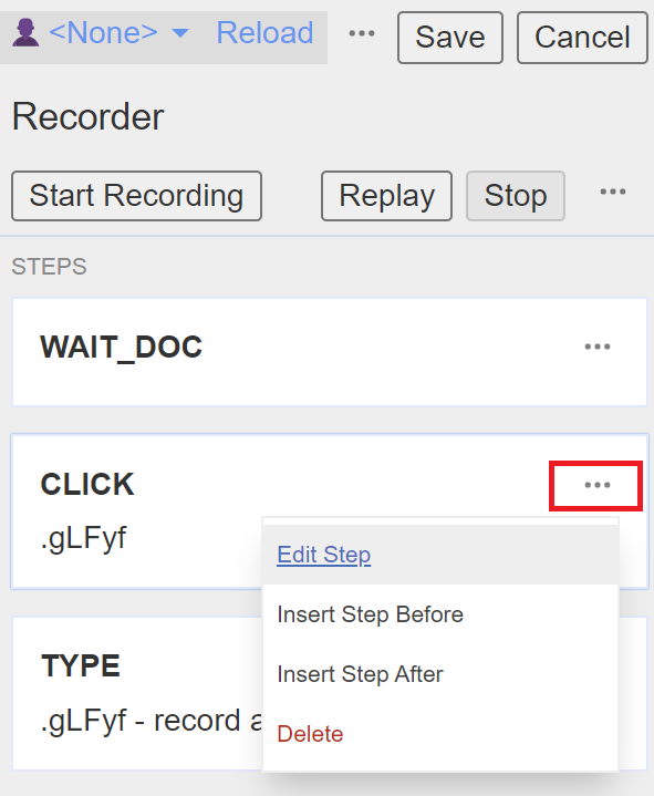

  1. I can not configure a macro to click a button for an out of stock item, because “Add to Cart” never appears on the website, unless the item is in stock. There doesn’t seem to be a way to do define what element is clicked when creating a macro. Is is possible to edit an action and replace the text in an element with what is expected?

Yes, editing and adding custom steps are already supported.
Awesome! I couldn’t find how to edit and add custom macro steps in the documentation. Can you share how I would do that?
It can be edited using the overflow menu:
Looks like I am missing that option:
Thanks! The extensions lag a bit. Because this feature was added very recently, it is only available at monitor.distill.io. Can you try using that? The extensions should get updated version in about 2 weeks.
Absolutely outstanding! I found it; thank you so much.
