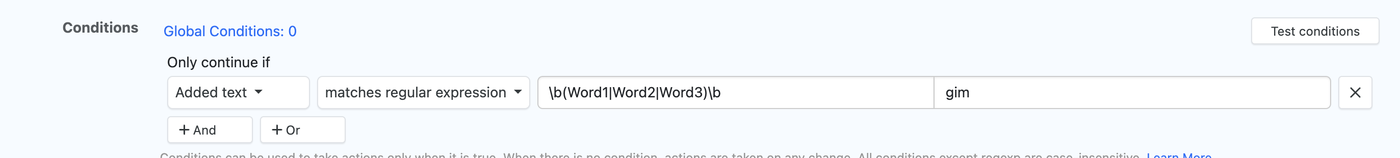

I see that the OR would indeed be better. However, would ‘Word1|Word2|Word3’ work?
@chilefree1988 Word1|Word2|Word3 would not work here. This field is not designed to use pipe-separated values, so the correct approach would be to use the OR condition instead.
@chilefree1988 Alternatively, you can also use regex here. If you switch the condition to matches regular expression, a pattern like \b(Word1|Word2|Word3)\b will match any of those words in a single condition.

thank you, makes sense. On expression I put the word with the symbols you mentioned. On Flags?
lets say Im looking for JOB123
what about \bJOB123\b and then in flag gi?
@chilefree1988 Yes, you can leave the default flags as gim.
Regarding the flags:
