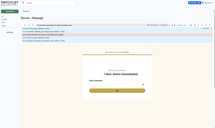

I noticed that after recording the steps for the password it shows type_secret and when I try to replay it, I still need to provide the password.
Update:
after watching https://www.youtube.com/watch?v=fSLGBqn2MGo

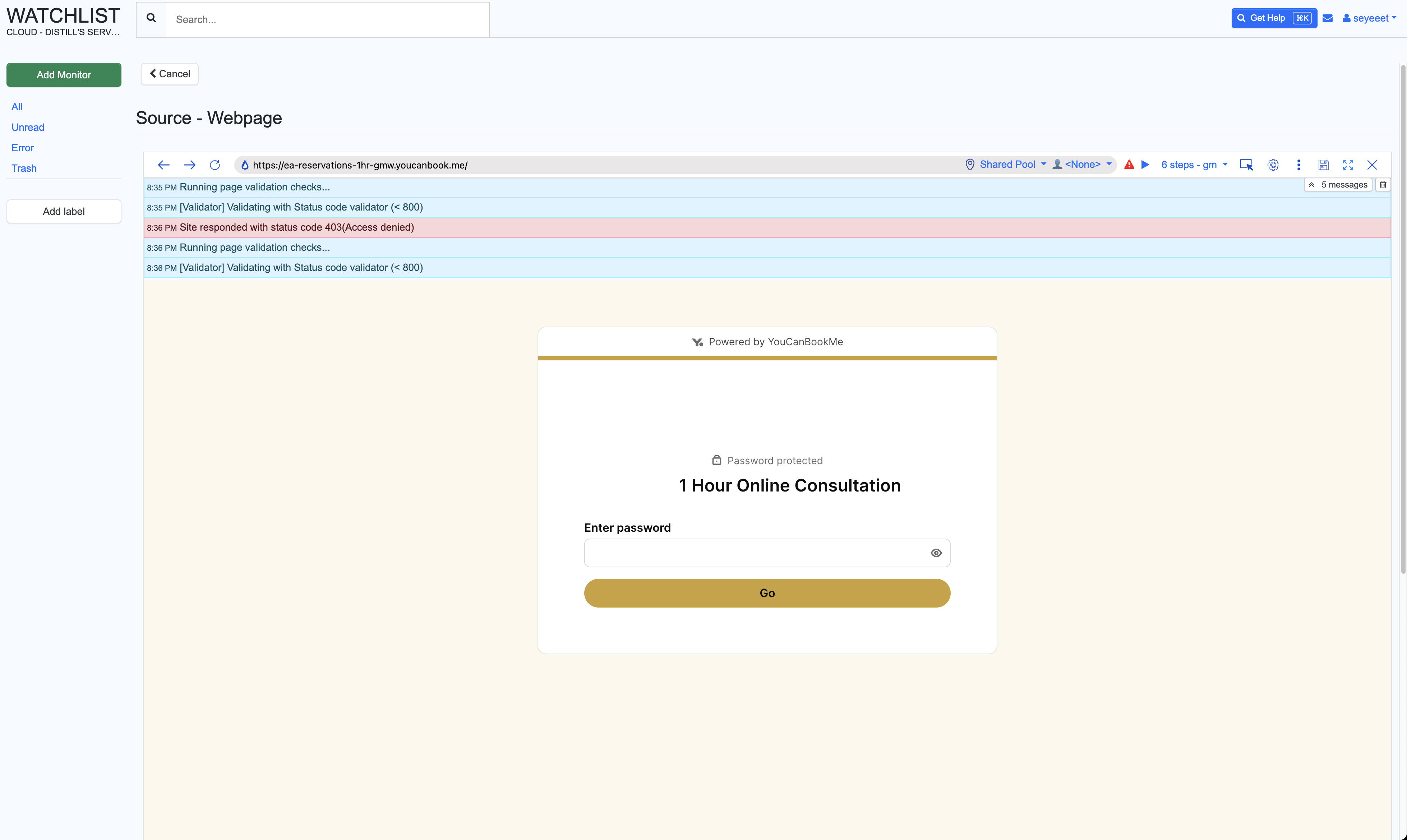

I still get the same error, the issue is
site responded with status code 403 (access denied)
is there a way to fix this issue?
@seyeeet can you try running it again and see if it works after retrying? once the macro is run, the password should be saved in the monitor’s config. it will then be used for checks automatically.
let me know if this doesn’t work. using a local device can be a good option in that case.
edit: the site returns 403 status code on initial access. we have updated the validator to not raise an error for this site. that should make it work.
Thanks, seems to be working now
