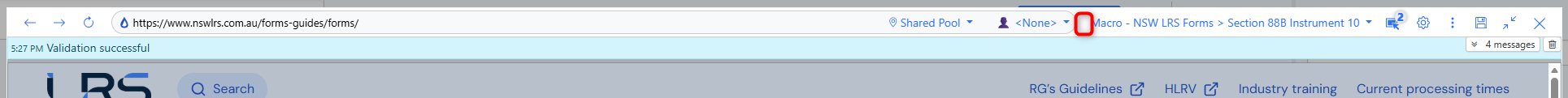

Macro 'play' button not appearing for a particular Macro that is applied to a monitor
Hi there!
We have monitor set up that is linked to a macro.
When you edit the monitor and go open the webpage selector, the ‘play’ button does not appear in order to activate the macro
Other macros are working i.e. a play button appears when you apply it to this same monitor.
Creating a new monitor and applying the problematic macro, still doesn’t make it work.
When you look at the macro, it looks to be set up the same as other macros (we can’t see what might be missing/causing the issue). It has same type of recorded steps as the other example macro tested above.
Appreciate your help :slight_smile:

Thank you that helped! I deleted the current macro, recreated it and re-assigned but it wasn’t working. It was I think somehow still recognising the deleted macro. I renamed the new macro and re-assigned it to the monitor and it then worked! yay! now I renamed it back and it still working - all solved.
