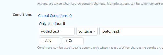

I have setup a very simple monitor. The only rule in the monitor is:
My understanding being that the rule is triggered if the part of the text changed contains the word Datograph. However I get many alerts and when I look in the page that caused the alert there is no track whatsoever of the word Datograph.
Am I doing something wrong?
Thanks
@aguida based on the condition, the monitored text must have contained the term “Datograph” when it triggered a notification.
can you check the notification status to see why the condition matched? see Optimizing Alerts with Conditions – Distill
click the bell icon in change history to see the notification status and condition evaluation’s result.
