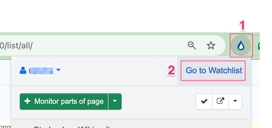

By default, local monitors run at their scheduled time based on the set check interval.
If you want to manually check local monitors, follow these steps:
  1. Open the local Watchlist by clicking the Distill icon in your browser toolbar as shown in the image below.
  2. Click “Go to Watchlist”.
  3. Select the monitors you want to check.
  4. Click the Run button (represented by a man icon).
Note: The local Watchlist URL will appear as moz-extension://... in Firefox and chrome-extension://inl... in Chrome.
