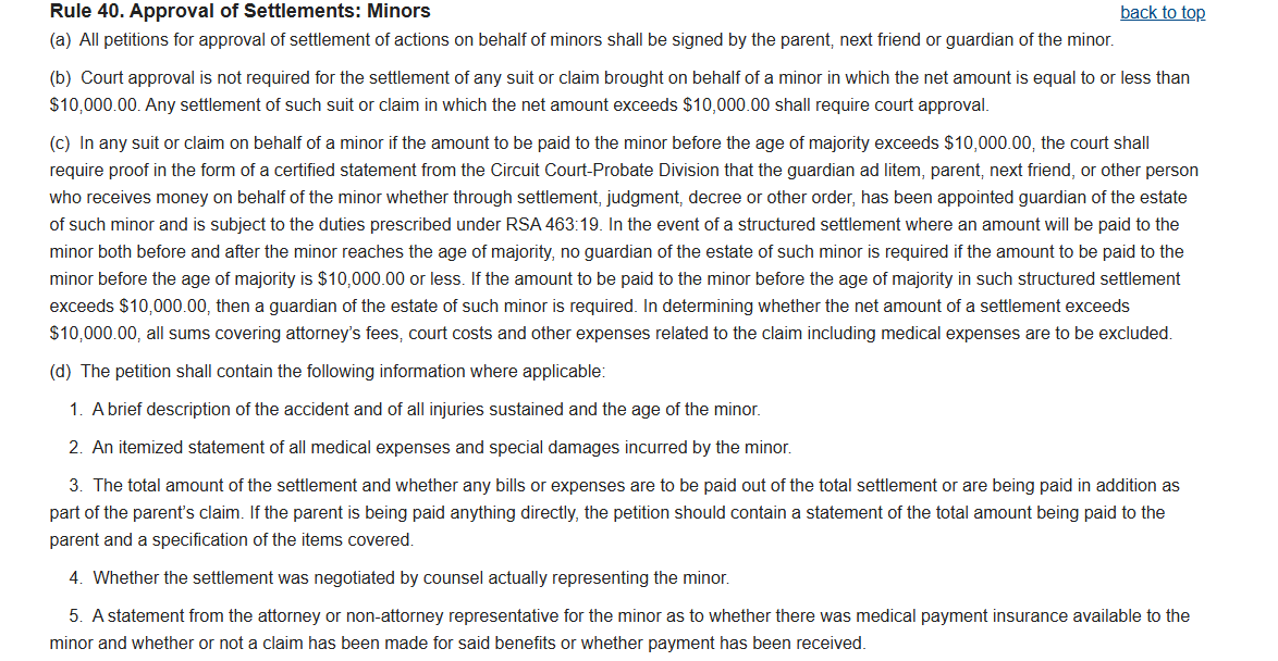

The following are answers to your questions as well as a screenshot of what should be monitored versus what the monitor is comparing too.
  1. Yes, the monitor is for a regular webpage.
  2. The page loads all at once.+

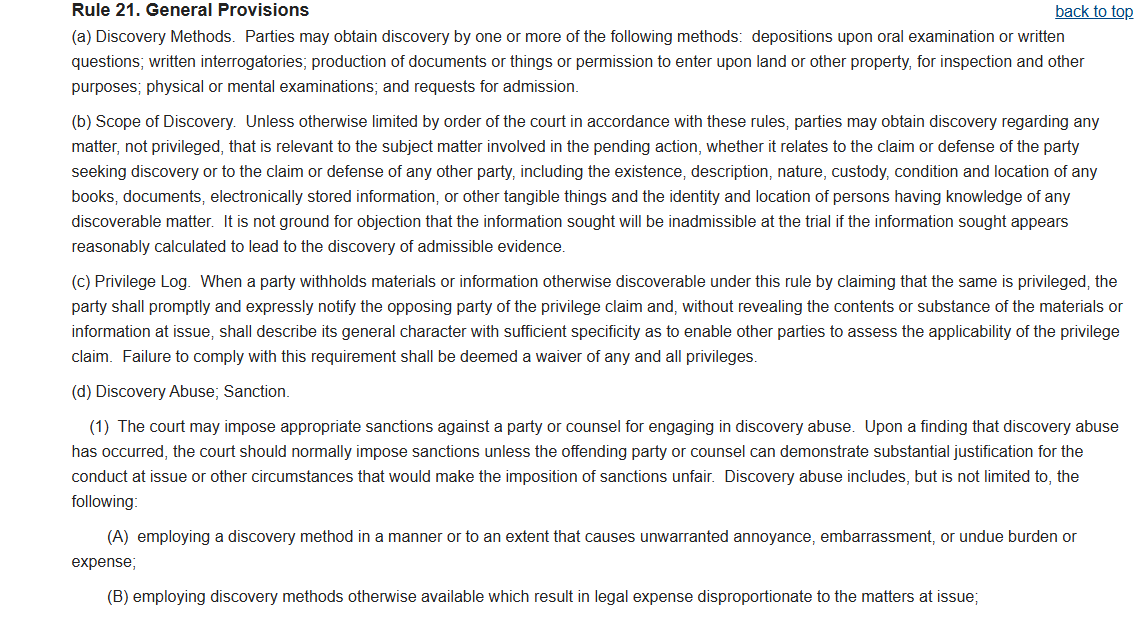

  3. The URL the monitor should provide alerts for is as follows: https://www.courts.nh.gov/rules-superior-court-state-new-hampshire#page-id-4391

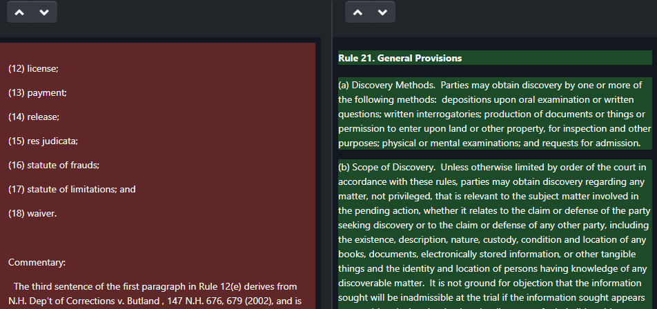

However, the comparison is coming from https://www.courts.nh.gov/rules-superior-court-state-new-hampshire#page-id-4491 and all of the text on this page
As you can see, the monitored URL is on a completely different page and there are no Macros established that would suggest moving between pages.
@amyh Thanks for the detailed information — that helps a lot. Based on your description and the screenshots, it looks like you’re monitoring a webpage that behaves like a digital book or table of contents, where different sections are loaded via fragment identifiers (e.g., #page-id-4391, #page-id-4491, etc.).
You’re absolutely right to notice that sometimes the monitor picks up content from the wrong page-id section. This happens because the base URL remains the same (https://www.courts.nh.gov/rules-superior-court-state-new-hampshire), and content for all sections may be present in the DOM or dynamically loaded depending on how the site is built. As a result, Distill might sometimes compare changes across the wrong section if the exact target area isn’t tightly scoped.
To ensure you’re only monitoring the correct section:
  • Try refining your selection using XPath or CSS selectors so that it specifically targets the content inside #page-id-4391.
  • You may also try increasing the “Wait for duration” setting (Inside the Settings of the monitor > Configuration) to ensure the page fully loads into the correct state before Distill makes the comparison.
