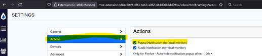

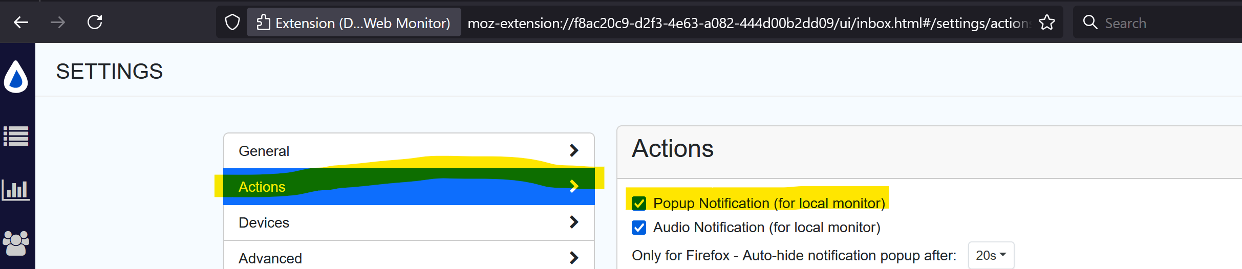

can you check if the option to trigger popup notifications was disabled under the extension’s action settings?
they’re checked :confused: screenshot https://files.catbox.moe/kcvnga.png

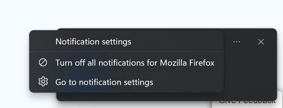

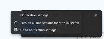

where are you getting this dialogue from? this: https://forums.distill.io/uploads/default/original/2X/2/23a8182d11ee296bfe2062a212451a894ceb1f34.jpeg

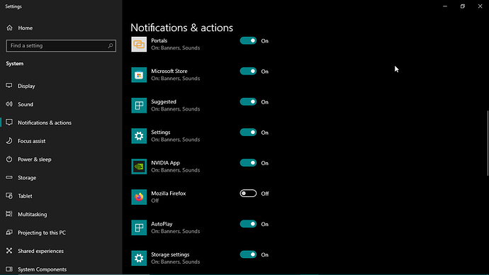

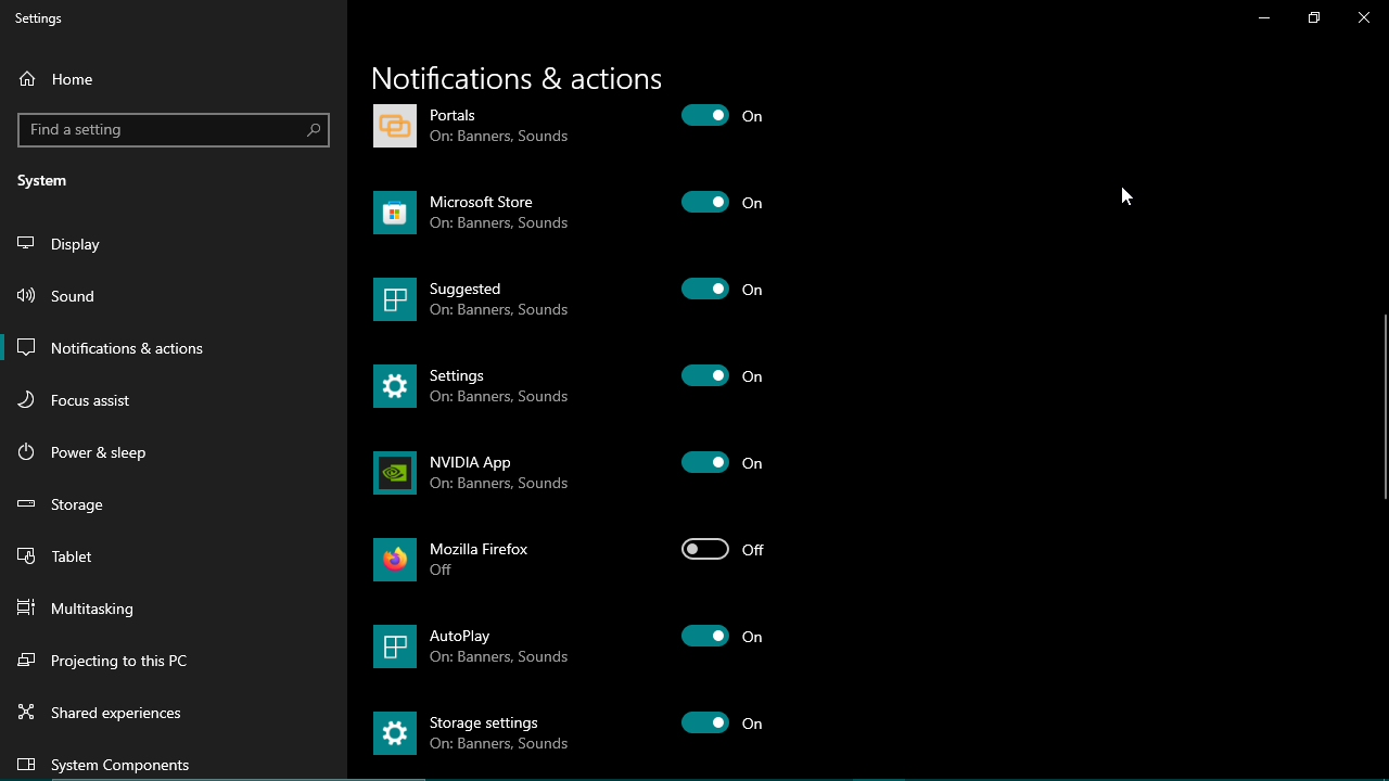

this is windows’ menu option for the notification popup. check the following answer out to see if you can enable notifications for mozilla firefox:
Solved! The popup was ultimately controlled by Windows. Windows setting for notifications held the key. Thanks for helping.
