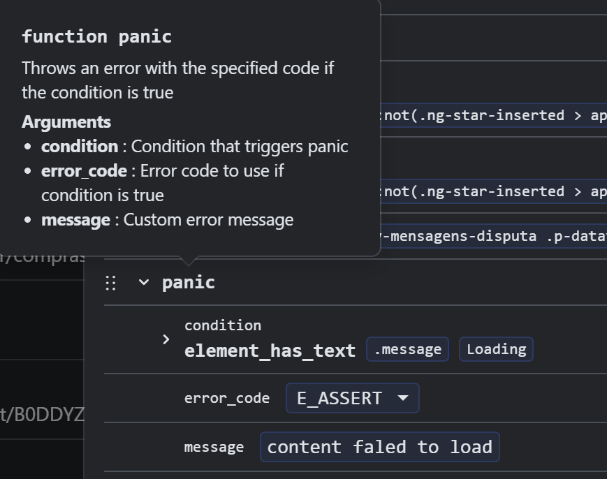

a macro’s panic function should help validate page’s content. if the page’s content is not valid, one can wait for a longer duration or even error out the check. for example, panic function can error out the check if a criteria is met.
here is a sample usage of the panic function:
panic(element_has_text(<element_selector>, "Loading"), )
if the macro panics and raises an error, this check will error out instead of capturing this as a change.
The website is always showing “Loading…” first. Wouldn’t it panic before?
Also, is there documentation about this command? I could only find it being mentioned on the forum.
use one of wait_for_duration or wait_for_element functions to make sure that you have waited enough.
the macro editor itself displays the documentation of the function. hover over the function after adding it. it will then display the documentation of the function. the signature is panic(condition: boolean, code: string[, message: string]). when a condition is true, the panic raises an error with the given error code and message. here is how to view and use it:
