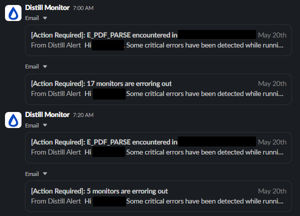

Here’s an example of what our notification feed normally looks like for the PDFs:
A notification when a first monitor errors, and then {Minimum time interval between notifications} minutes later, the rest of the failing monitors are sent. Then after the retry delay, one notification, and then all the rest in a group after.
