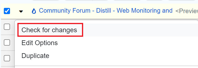

I meant forcing the check manually as shown in the following screenshot:

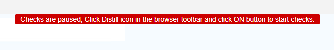

When I selected “check for changes” in the desktop app, I received a red error banner up top that says "Checks are paused; Click Distill icon in the browser toolbar and click ON to start checks. Do you know what browser toolbar it is referring to? The Distill browser (which opens when you click a link from the desktop app) doesn’t have a Distill icon to click on. And I don’t see any Distill icon on the desktop app itself that I can click ON to start checks.
I’ve turned the time slots on and off and enabled 24/7 monitoring from there and it didn’t make a difference. The issue seems to be above, but I don’t know where it is telling me to manually turns the checks back on.

Thanks for the screenshot. This looks like a bug in with the way it handles time slots. We will fix this soon. Will let you know once the update has been released.
