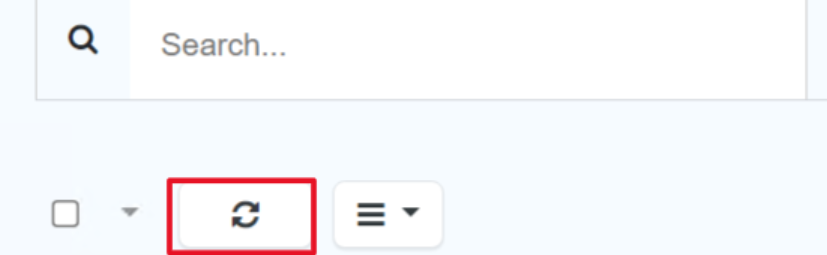

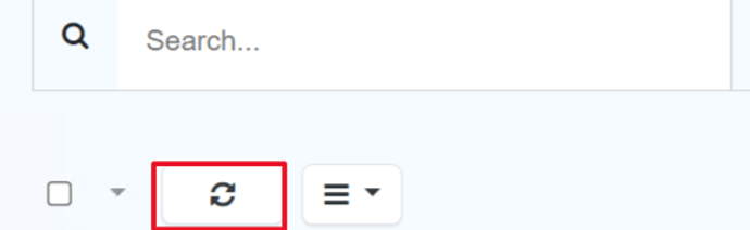

In the desktop app, there is a sync button.
Currently, when this button is pressed in the app, the changes made in the browser are synced to the app. Is it correct to understand that, originally, the synchronization should occur automatically without needing to press the button?
