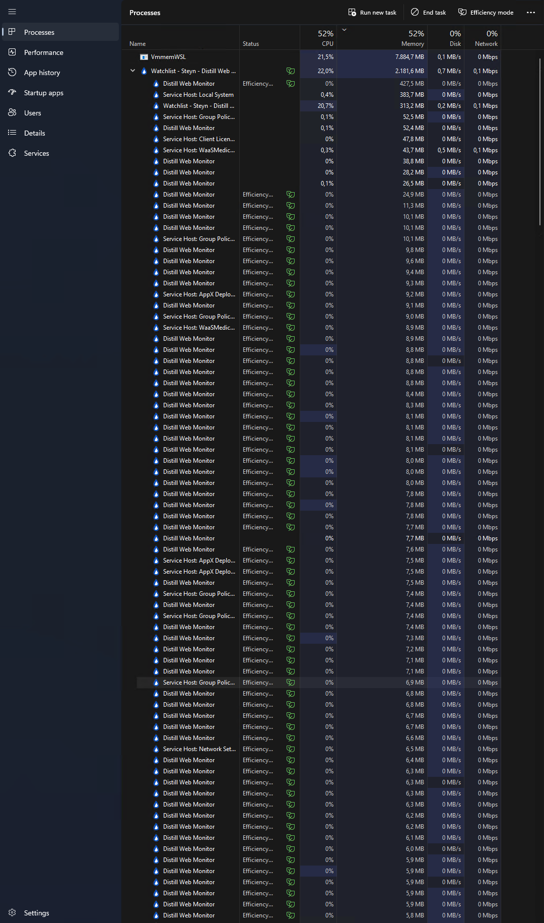

  1. 10 concurrent workers are used for checking.
  2. it seems to keep an extensive amount of workers working when it’s slow.

Hello @Steyn,
Thanks for providing more info about the errors.
Are you running static monitors (monitors with JavaScript disabled) as well? We were able to find a scenario with static monitors where this happens and implement a fix.
Also note that some of the processes takes some time to get killed (processes like Service workers in a page). A total of around 6-8 processes are bound to run when the app is active and not running any monitors.
