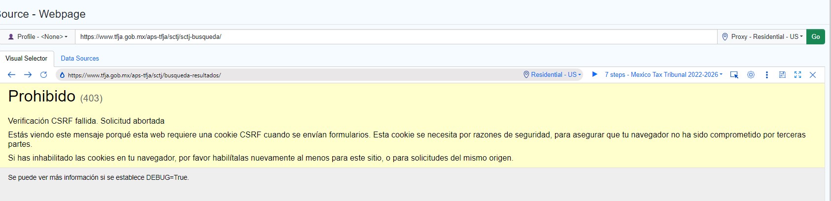

Ok, how do I circument the following cookie message?
I need to run a macro on a Mexican site and that’s the message above after I ran the macro. If I understand it correctly, I could only set up the local monitor when the website monitor has been added.
@alextaxanalysts - The “Prohibido” message appears to be an error message. https://translate.google.com/?sl=auto&tl=en&text=prohibido&op=translate

Note that the screenshot shared earlier is not a cookie popup but an error page denying access to the page. The key will be to find out the reason and then solve that.

I am able to reproduce this error. It is intriguing because the macro recorder is able to replay it everytime but the selector is not. We will look into this and get back to you. Thanks!
@alextaxanalysts - a fix for the bug has been deployed today. Can you reload the Watchlist and try using the macuo in visual selector now?
Thanks, it works now, perfect!
