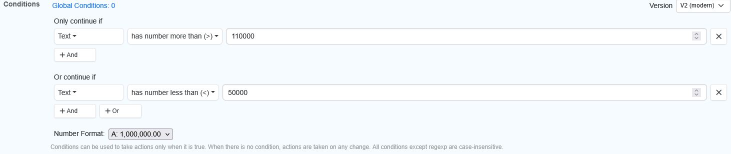

My conditions are:
  • Only continue if number > 110000
  • Or continue if number < 50000
  • Number Format: 1,000,000.00
Despite this, Distill still fired for #105,665 which is not greater than 110k and not less than 50k.

  2. If possible, please send us a screenshot of the Conditions setup for your monitor. This will help us validate whether the logic is correctly applied or if any tweaks are needed.
Here are my conditions. I don’t see any option to test conditions.
