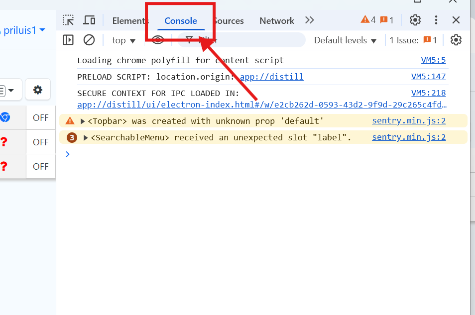

Please follow these steps (Windows):
Run the Desktop app in debug mode
  1. Go to the following folder:
    C:/Users/your-username/AppData/Local/distill_web_monitor/app-4.1.0-beta/
    (“your-username” will be your actual Windows username)
  2. Inside this folder, look for:
    distill-web-monitor.exe (lowercase name)
  3. Open Command Prompt in this folder
    Run this command:
    distill-web-monitor.exe --enable-dev-tools
4. The Desktop app will open with developer tools
5. Go to the Console tab
Please take screenshots of the entire Console Tab and share it with us. This will help us identify the issue and fix it quickly.

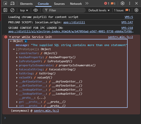

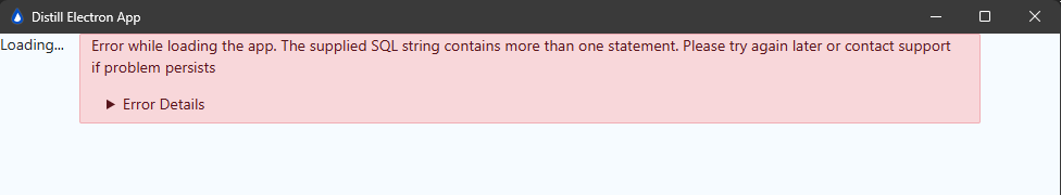

I’m not the original poster, but am seeing the same error today. Attaching screenshot of console …
Also pasting from the command prompt …
Failed to init distill service: RangeError: The supplied SQL string contains more than one statement
at Database.prepare (C:\Users\####\AppData\Local\distill_web_monitor\app-4.1.0-beta\resources\app\node_modules\better-sqlite3\lib\methods\wrappers.js:5:21)
at execQuery (file:///C:/Users/####/AppData/Local/distill_web_monitor/app-4.1.0-beta/resources/app/electron/store.js:100:28)
at file:///C:/Users/####/AppData/Local/distill_web_monitor/app-4.1.0-beta/resources/app/common/util.js:101:12
at new Promise ()
at file:///C:/Users/####/AppData/Local/distill_web_monitor/app-4.1.0-beta/resources/app/common/util.js:100:14
at createViews (file:///C:/Users/####/AppData/Local/distill_web_monitor/app-4.1.0-beta/resources/app/common/store-sql.js:209:11)
at process.processTicksAndRejections (node:internal/process/task_queues:105:5)
at async file:///C:/Users/####/AppData/Local/distill_web_monitor/app-4.1.0-beta/resources/app/common/store-sql.js:247:9
dom-utils: app ready
electron-main:dom-utils:ready: opening main app window
I downgraded to 4.0.2 beta from the website, and it launched OK. Unfortunately I don’t see any option to disable automatic updates, so I’ll probably get pushed to 4.1.0 beta again and need to downgrade again on next reboot…

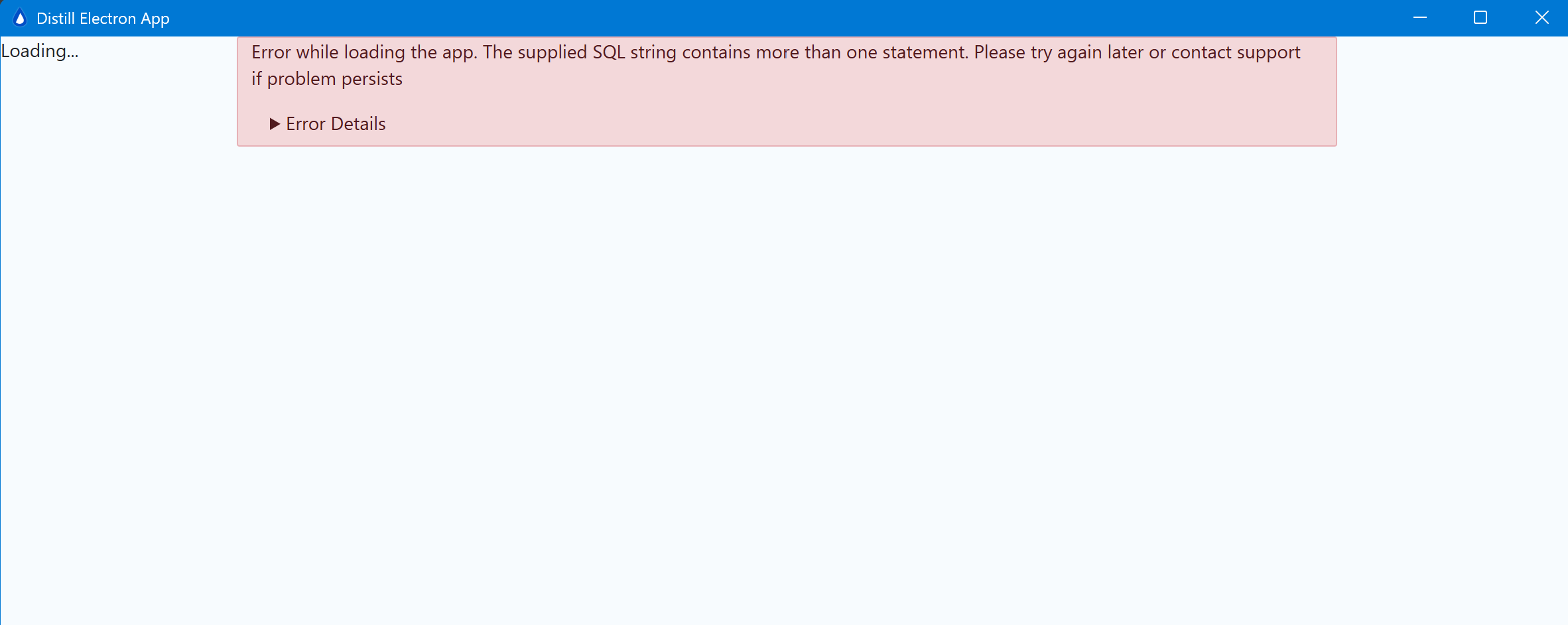

I have the same error. Started less than 12 hours ago.
can’t upload the log file so here you go. No console tools were available, looked the same as my screenshot in the previous post.
