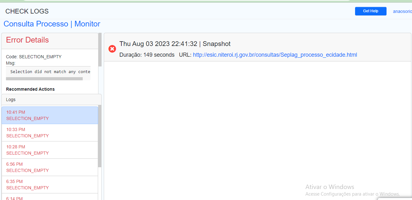

Ajit, thank you for the reply. I created a macro as instructed. When clicking on the play button, the actions occur correctly. However, when the monitor is checked, the error SELECTION_EMPTY appears.
I see. What does the snapshot in error details[1] show?
[1] How to view logs of checks? – Distill
Selection did not match any content
The snapshot the page’s state when the error occurred. Make sure to click the “view details” link next to the error code in the log. Can share a screenshot of the snapshot?

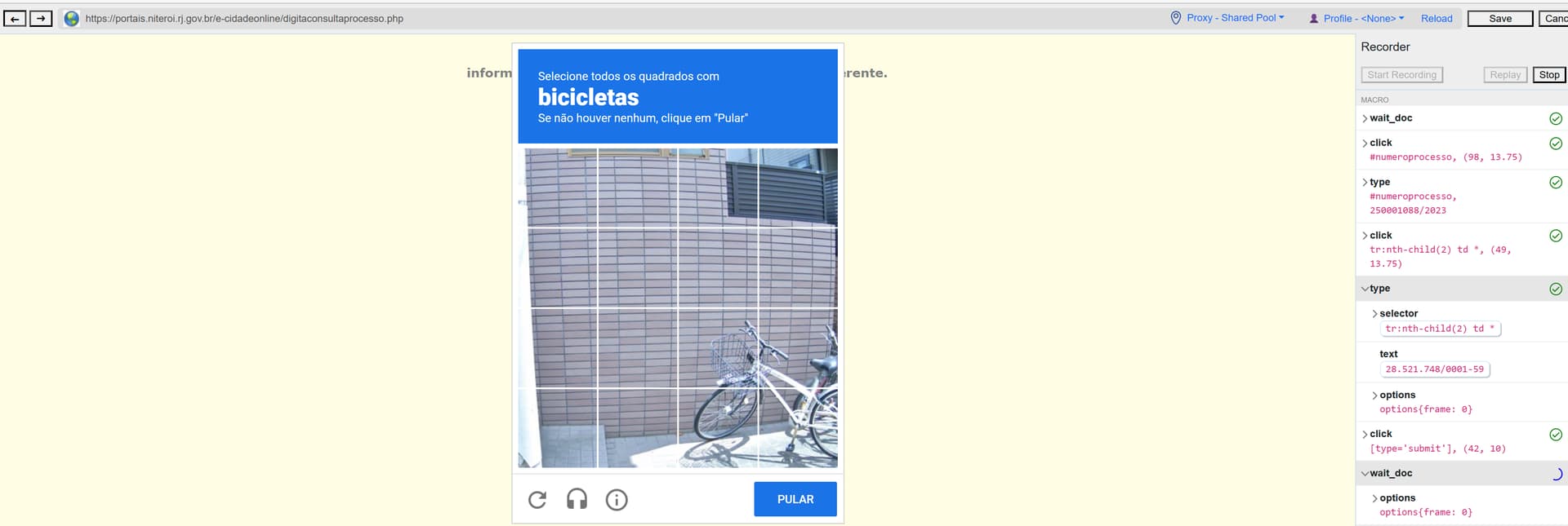

Hello @anaosorio, the page has an iframes that made it slightly tricky to run the macro. In this case, it is easier to automate the steps by opening that iframe as a page. The iframe’s URL is:
https://portais.niteroi.rj.gov.br/e-cidadeonline/digitaconsultaprocesso.php
Can you try creating a macro for this URL and see if that works better?
Note that sometimes, the page can show a captcha.
In this case, it could work better if you could run monitor locally using the browser extension.
Let me know how it works. Hope this helps!
