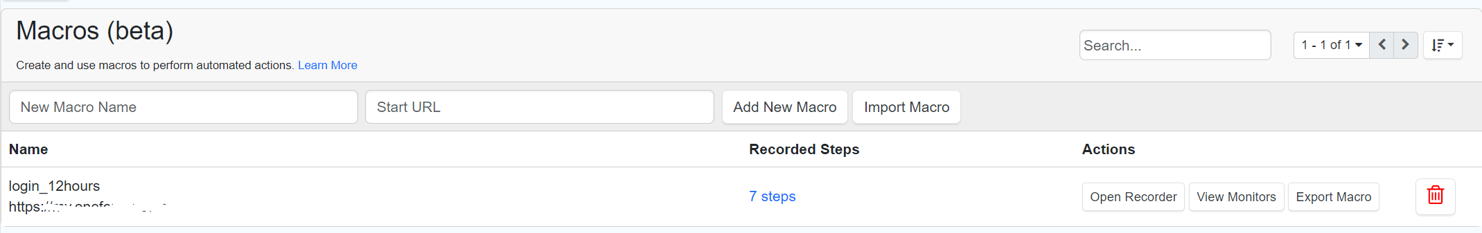

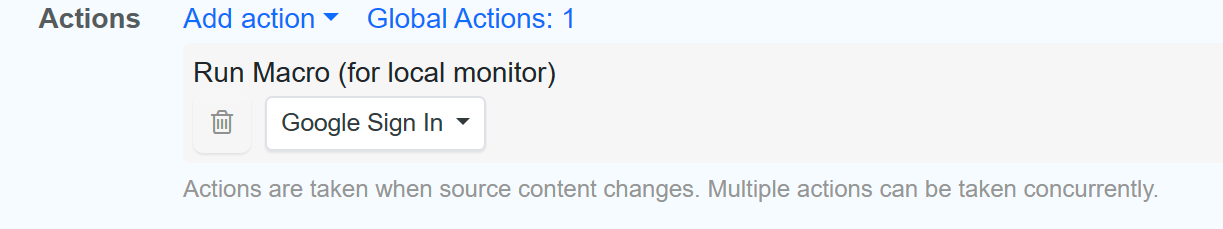

Just one last thing. I’m trying to add a Macro to the monitor but it doesn’t show the available macros.
See image below:
This sounds similar to I can't select a webpage and then a macro?. Can you check the macro’s URL and the monitor’s URL to see if they are from the same domain/subdomain?
