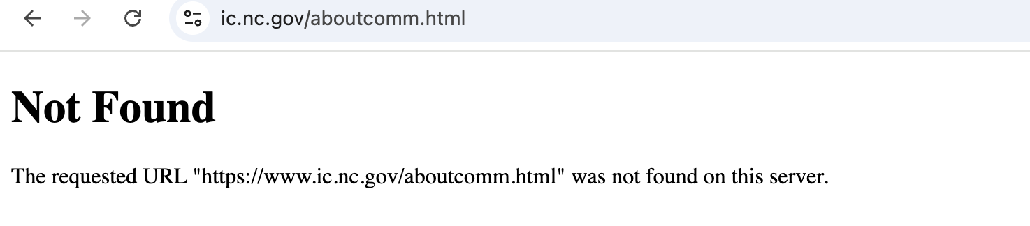

So, this URL works with desktop - https://www.ic.nc.gov/aboutcomm.html but not with cloud
We already have a common workspace for our team. If I set up local monitoring/Distill App for a particular website within that workspace, will the monitor be visible and accessible to everyone in the workspace?
Also, how does the local monitoring work in this case? Does the monitoring run only when the Distill Desktop App where the monitor is set has to be open and running, or will it continue to work automatically because the monitor is part of the shared workspace?
@srimathi.venkatachal This webpage is not found https://www.ic.nc.gov/aboutcomm.html
Would you be able to confirm if this is the exact URL?
